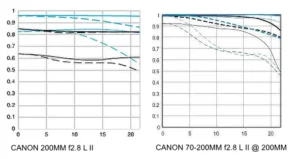

When comparing the Mark II and Mark III 70-200mm L lenses, some have observed that the later lens took a tiny step backwards in terms of central frame resolution at wide apertures at 200mm in favour of slightly more consistent performance across the frame. The Mark II did suffer from the ‘Zone B Dip’ we’ve commented on before. Compare the following MTF charts from Canon, which predicts the zoom to be sharper in Zone A than the prime. But note the matching of meridianal and sagittal lines with the prime . . .
Fortunately several sites have made direct or indirect comparisons of the contemporary Mark II zoom and 200/2.8 prime. There isn’t a perfect consensus: blame sample variation, test method errors, and/or undisclosed variation in working distances at which each test was conducted.
