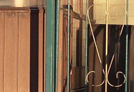

35mm / f2.8: extreme corner
Tamron 28-75mm at 35mm / f2.8
100% crop - extreme corner
Contax Zeiss Distagon 35mm / f2.8
Sigma 24-70mm at 35mm / f2.8
This is why I never test wide angle lenses wide open: who wants corners like this? Straight away, though we see the infamous Sigma yellow rearing its head and the 24-70mm already out-rubbishing the rubbish corners of the others. What do you expect? Centre frame, however, it's a different story...

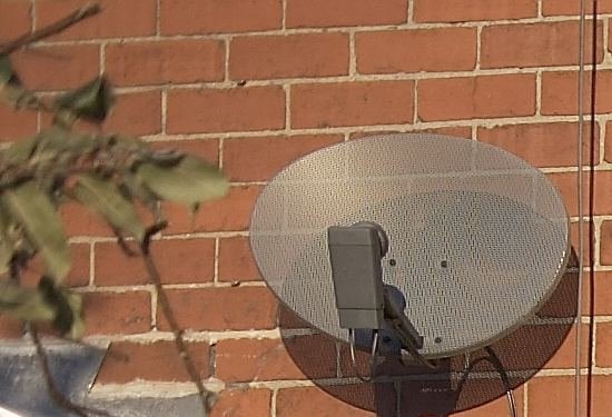

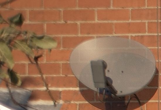

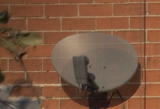

35mm / f2.8 (centre frame)
100% crop - centre frame
Very impressive centre frame performance by the Distagon and a surprisingly great result from the Tamron - which I was expecting to look more like the increasingly depresing Sigma. Let's see what those corners should look like - at f4...

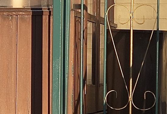

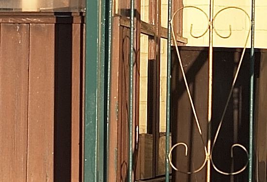

35mm / f4 (extreme corner)
Tamron 28-75mm at 35mm / f4
Contax Zeiss Distagon 35mm / f4
Sigma 24-70mm at 35mm / f4
Wow. That's why Zeiss has its reputation: absolutely wirey corners at f4 - the resolution doesn't quite extend to the cornermost pixels, but for 99% of applications that will do very nicely. And the Tamron, too, takes a quantum leap, rendering very credible corners at f4.
